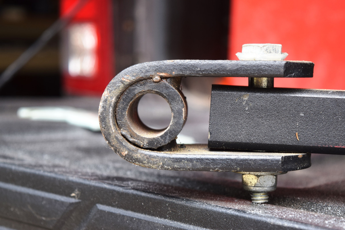

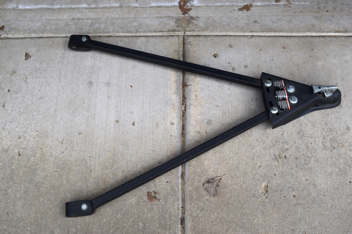

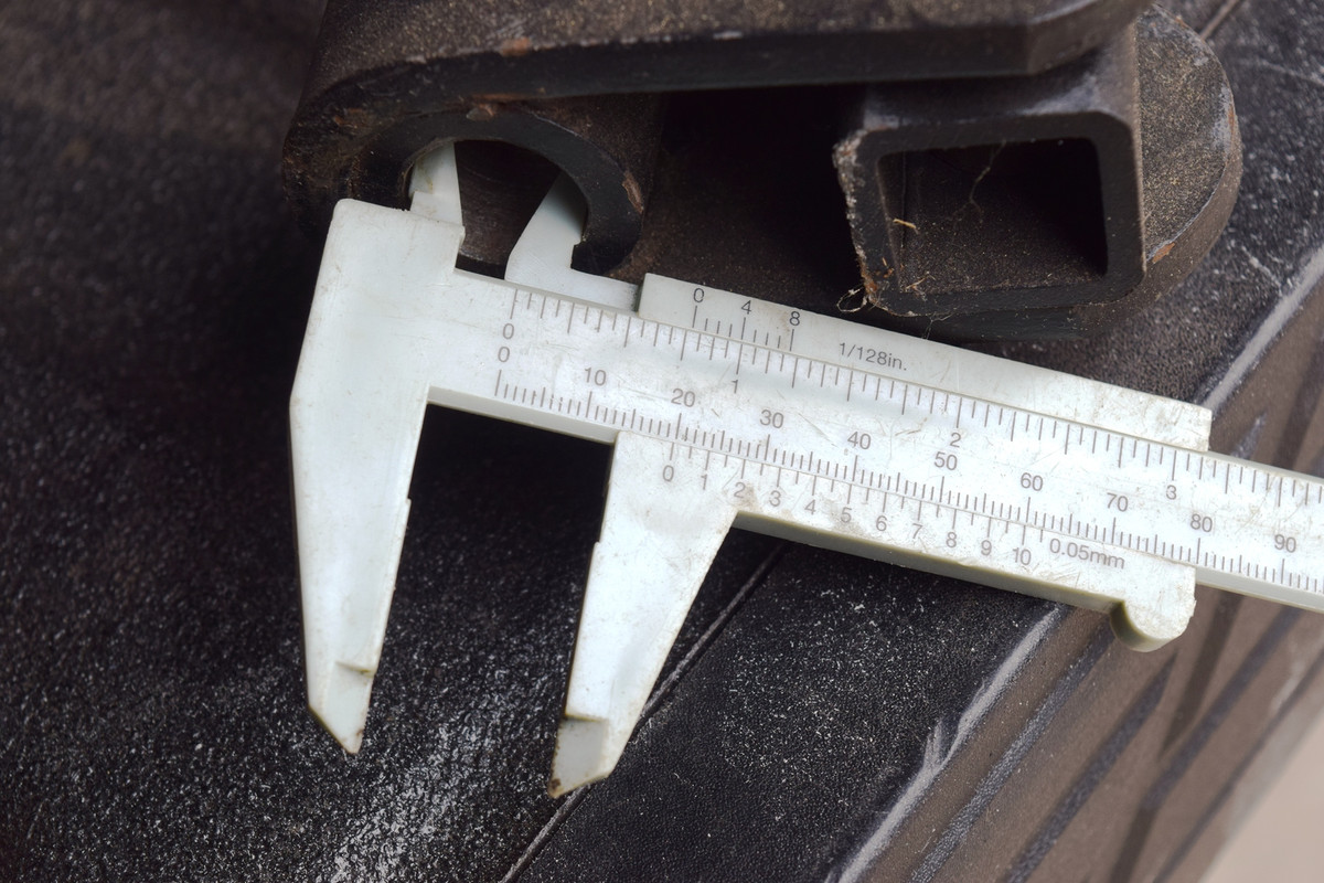

Post by Cabin Fever » Tue Apr 06, 2021 12:37 pm
Yes, I have done this.
I purchased an off-the-shelf tow bar for towing my M38A1. I believe it is a Curt Manufacturing tow bar....not sure as there is no manufacturers information on the bar.
The width of the connector (below) is 2" wide. It fits perfectly into the front lifting shackle bracket of the jeep with no slop.
Out of the box, the connector hole was too narrow to accept the 3/4" diameter of the shackle pin. So, I drilled it out to 3/4" diameter,
Now it all fits perfectly and hook up is fast and efficient. When I get to the parade I remove the shackle pins, pull off the tow bar, and replace the shackle rings and pins. I am ready to go!
Let me know if you have any questions.
