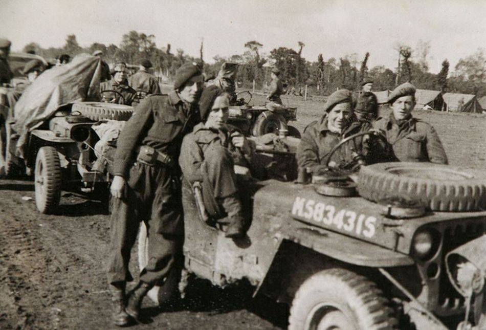

don't know if this has been posted before, but it looks like the Brits put their spares on the fronts of the jeeps in this Market Garten foto

The Brits in Europe covered up the grille with the spare tire and cut out the grille in Africa...

In the last image I cannot clearly see the beret flash on the far right trooper. Is that SAS? The jeep bears a lot of similarities to the ETO SAS jeeps

Old thread but worth comments. Yes that looks like an SAS badge. Very obvious these are Special Air Service training for or in France. They started parachuting in small groups deep behind the Normandy lines on 6 June 44 and were equipped like British paratroops. Note the bellows pocket on one trooper's airborne trousers. Berets were standard airborne maroon at the time although some North Africa and Italy veterans still wore the sand colored ones. Jeeps were parachuted to them about three weeks later, and they marauded 100-200 miles behind the lines in many areas interdicting Germans heading for Normandy, blowing up railroads, derailing trains, spotting for the RAF and USAAF. The jeeps had standard British airborne mods like short front bumpers, no side steps, wheel located to the front or the hood, all for making the turn into a Horsa glider at the top of the ramp. And no rear grab handles. Normally a support strut went from front bumper to each fender because they would mount boxes on the fenders. See the cut bumper on the second jeep.
The cut grill was distinctive of the SAS. A mod for the heat in Egypt and Libya, it became a tradition. Turns out the missing slats made it easier to patch bullet and shrapnel holes in the radiator using plastic explosive which they usually had with them. This jeep has a gun pedestal in the usual cowl location. They put twin Vickers Ks there, and two on a pedestal on the rear of the tub. They dotted magazines on the hood and elsewhere on special post brackets. The jeep behind it most certainly has covered twin Vickers on a cowl pedestal, turned toward the driver. The ones on the jeep in the background are facing forward and up. This makes it nearly certain these are not airborne reconnaissance troops, whose jeeps also had airborne mods and they used the Vickers K but only one on a cowl mount and not normally seen with a lot of magazines about. Another SAS giveaway was the gas tank mounted below the gunner seat. That's not the muffler. It was a sectioned standard tank because there is less room there than on the driver side. They wanted more gas capacity because resupply behind the lines was spotty.
This thread is about spares on the front. The Brits had a bracket for supporting a wheel between the frame horns, and one for hood mounting which freed up the bumper area for a big storage crate. Often the SAS made long trips and had to carry a lot. This was when they were changing camp locations or after the Normandy breakout when the lines were fluid, relieving units could make their way to operating areas on the ground and relieved units went the other direction. Same in 1945 when moving into Northern Germany. At that time the jeeps had armored windscreens and armored rear tub.
There - more than most want to know!
