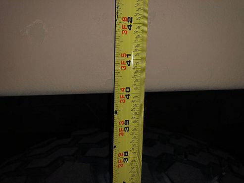

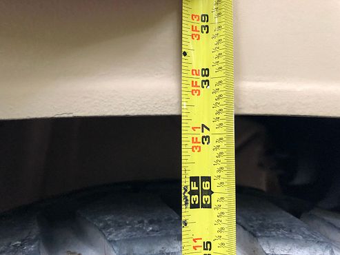

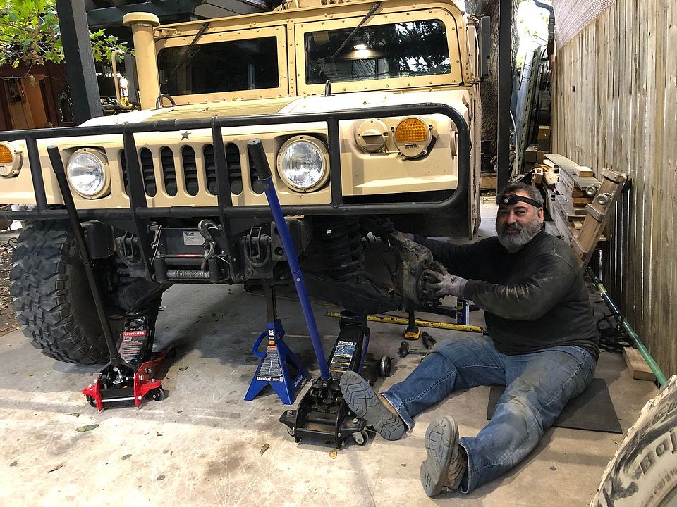

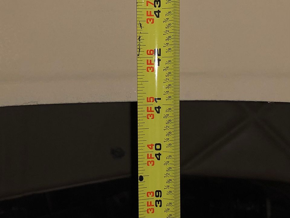

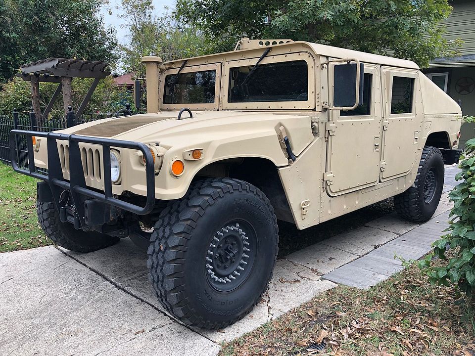

After getting back from the range I needed to do some work on my HMMWV having a few days off. I finally going to get around to replacing my front springs and shocks. I have been wanting to do this for a while just never had the time. I plan to also add 1" lift spacers for the front and rear. Here is the before:
The front was sitting at 37" and the rear at 40"
Tearing it up.
After finishing the front it lifted 4"
Then on to the rear sitting at 40" and installing the 1" spacers lift it lifted by 2" go figure to 42"
Here is the vehicle after lifting it. I really like the lifted stance a much better look. The front is now at 41" & Rear at 42"
Robert

The 4" of front lift from the new springs is interesting to see. I've had a set of NOS front springs for some time that I haven't installed it, it will be interesting to see if my results are as dramatic as yours when I get around to it.
Out of curiosity, did you measure the distance between bottom edge of each lower control arm front cross member bracket to the floor/ground before and after? The method I'm aware of for proper suspension height (albeit technically for the H1) I found here https://www.flashoffroad.com/Maintenanc ... ings_1.htm
If nothing else, I'd be interested in what your after measurement is for the linked method.
Hell On Wheels
Posts: 1343
Joined: Fri May 04, 2007 2:19 pm
Location: San Antonio, TX
Re: My evolution of my M998
Post by Hell On Wheels » Sun Nov 28, 2021 8:55 pm
I should take a measurement to compare to the chart but I don't have the start measure to compare. But then again I have many non 86 items all thru this HMMWV.
