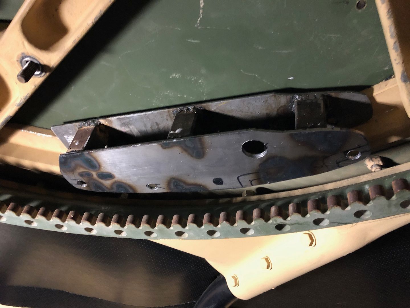

If you use that turret tray, you need to raise the try up With the thick adapter...while it may work, your brush lengths will need to be trimmed. How did you bolt up the motor? Your bracket on this green motor is for m1114 and in order to use the motor, you generally have to use use the m1151 motor bracket.
Funny you ask, I made a sample bracket out of wood and transferred to flat steel to make the final version bracket. Im not expert on welding but it will hold.

86humv had or has some repros

M1151 motor bracket...Available
