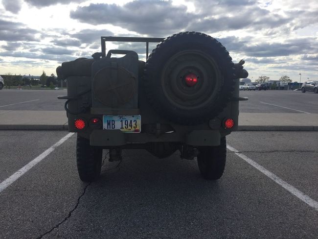

I use my MB a lot and got tired of hearing the squealing brakes behind me... I made up some 6v LED tail/brake lights from reflector assemblies and some 4" PVC pipe. I agree with Ernie -- nobody knows what hand signals are anymore. People would just wave back at me.

That’s one of Paul’s LED bulbs in the stock housing on my MB. It is much brighter than the stock bulb, but you can see how it compares to my homemade lights.

My recommendation is to source an intervehicular cable - plug one end into your trailer socket and wire an aftermarket light assembly to the other end, and mount the light in the center of your spare tire. I felt much safer with this.
