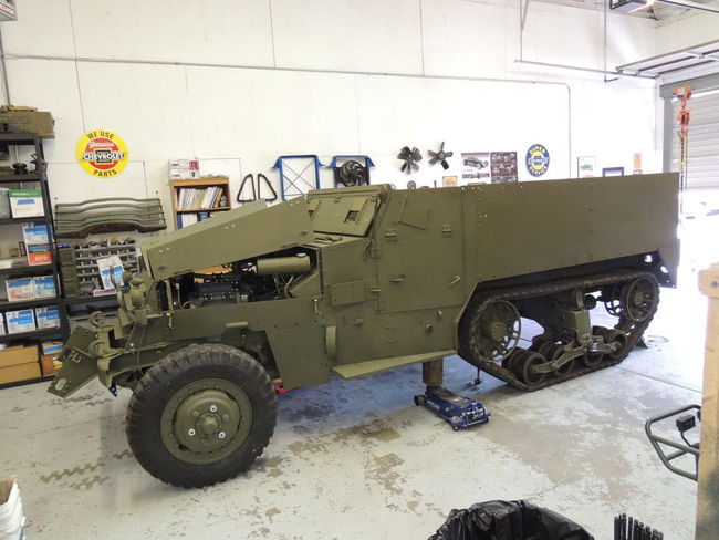

More photos of the progress!! :D

Don And I got the fenders on tonight and pulled ZELDA out for some photos. Yes ZELDA is the track's name. I will let Don explain that to you. Good Story. Any how it is as complete as it is going to get at this point for Tower Park. Here are some photos.
OK that was the good news. There is some bad news. You know the saying one step forward, two steps back. Well, we have experienced a lot of that with this project. The latest in that is while we were hanging the first fender Don found a puddle of brake fluid under both rear brake plates which means both wheel cylinders are shot. :( No time to fix now so he capped off the line to the rear brakes and we will deal with that after Tower Park. To top that off I went next door to my other shop to find a puddle under one of my rear brake plate which means mine is leaking also. Sound like we will have to de-track both vehicles to fix brakes when we get back. Oh well, time for some fun first at Tower Park. :)
