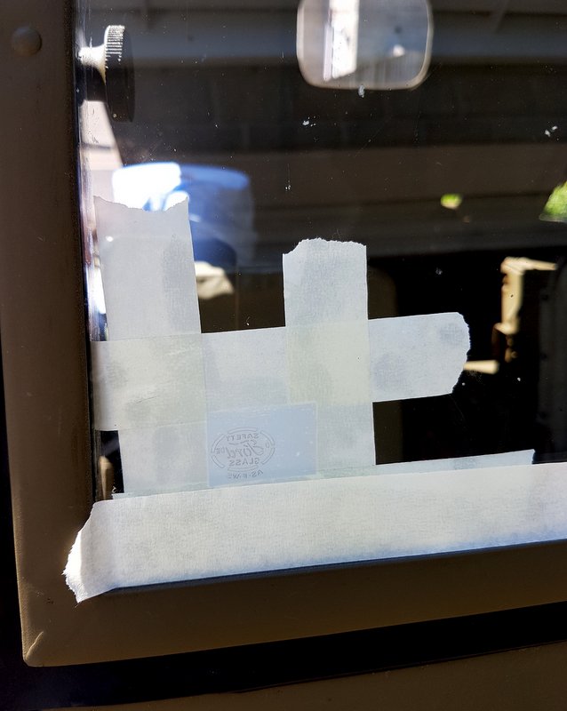

Thanks to the forum I was able to locate someone who produced the correct stencils for etching the windscreen (thanks Marc Belanger!).
I used Farrel Fox's good thread to give me some pointers on how to etch the glass and used armour etch which I found to work perfectly. Unlike Farrel I put the liquid on for 2 minutes (says to do for 1 minute on the instructions) and I also did not put on a thin layer like he suggests but liberally doused it to make sure that all areas were covered with a thick, even, coating so that they would etch with no patchiness, this seemed to work. Unless the Armour etch that I used to his is different I think theres a bit of misunderstanding on his thread about the requirement for the armour etch to 'dry', it doesn't need to dry as it is just an etching liquid and the etched glass can't be smeared either when removing the stencil as all you are doing is removing the liquid to stop the etching progress, that is not to say you cannot accidentally rub the armour etch onto the glass you don't want to be etched when removing it so be careful and have lots of water on hand to douse it!
Backside of stencil during etching process to make sure that none has bled through the tape and is etching where it should not be (would be a disaster)
Front side of stencil showing the liberal application of armour etch to make sure that an even etching is achieved
Finished product with the glass dirty on the other side (etching side has to be totally clean)

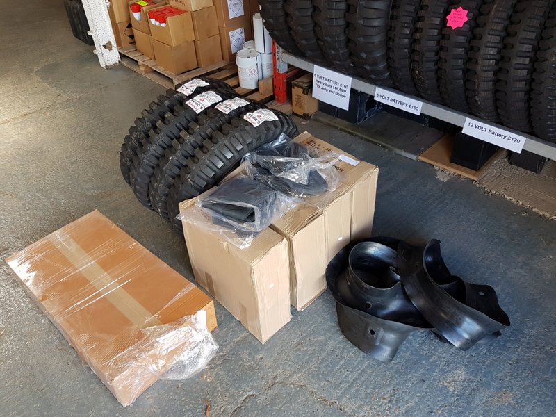

Wheel and rear seat day! Very pleased with all these bits and these firestone tyres are great looking, may not be able to fit tyres for a while as I need to spray the rims and the weather is bad for the next few days. Not sure where the Ford repro seat comes from but it looks very nice too, overall very pleased!

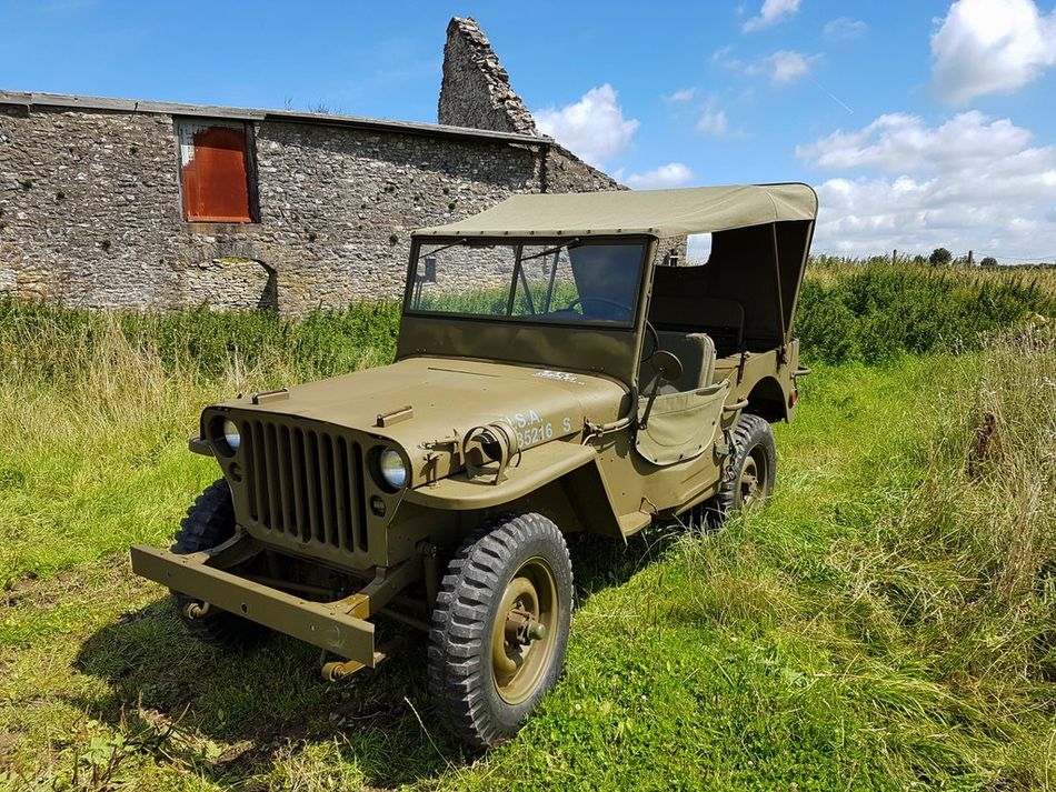

Guys, I had this crazy dream last night that it was 1945 again. For some reason I was at an end of war surplus auction and there were lines and lines of brand new GPW's lined up as far as you could see, they were all missing their spare tyres and pioneer tools but otherwise totally complete with just a few miles on the clock. They were all unmarked except their serial numbers on the hoods and the greasy hand prints from the factory workers . I walked down the rows of GPW's and picked one out paid a few hundred dollars for it and drove it home, it smelt of grease and canvas and all you could hear when you drove it was the gentle hum of the bar grips on the asphalt and the thumbscrew chains gently swishing in the wind.....
3 years later, a couple of thousands of hours of work and a lot of money later and 268333 is mostly complete again just (nearly) like she was in 1945, ready to fight a war she was built too late for, I hope that she will still be here long after i'm gone!

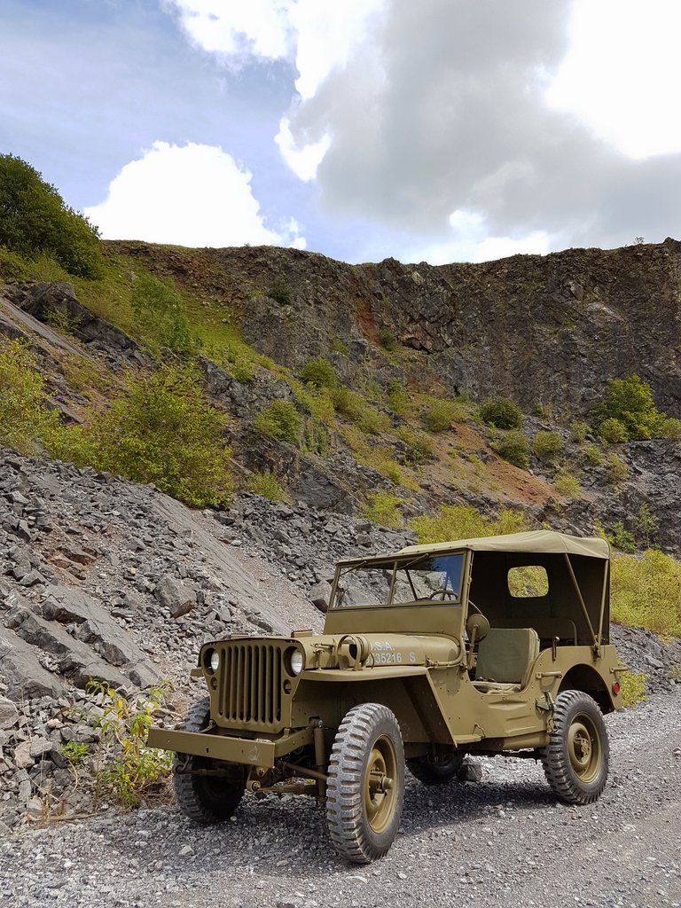

Hi Guys,

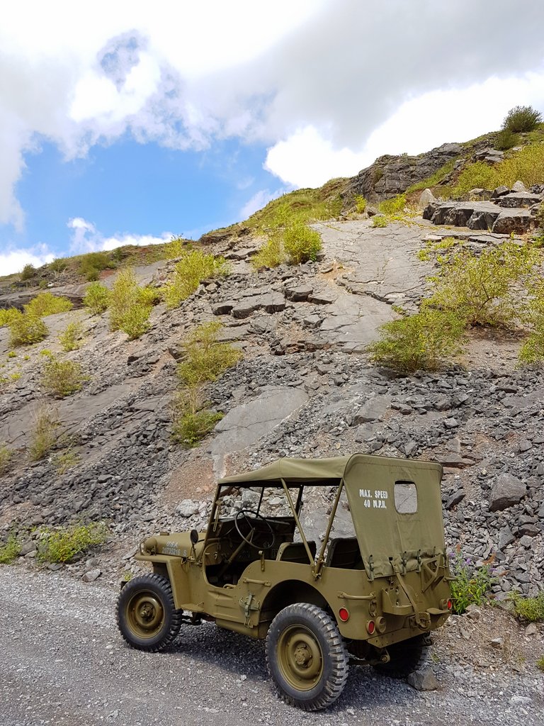

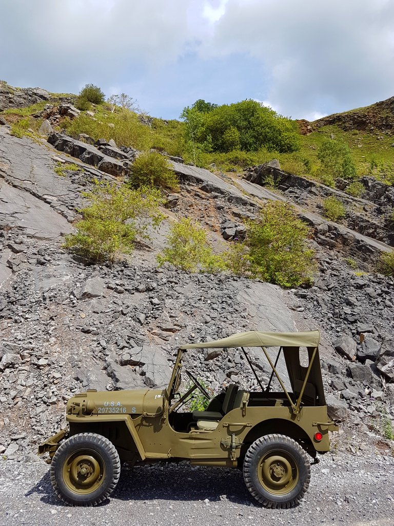

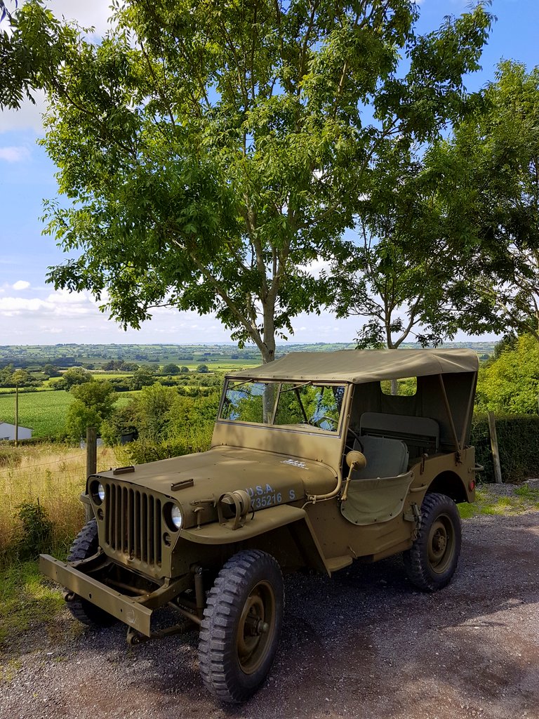

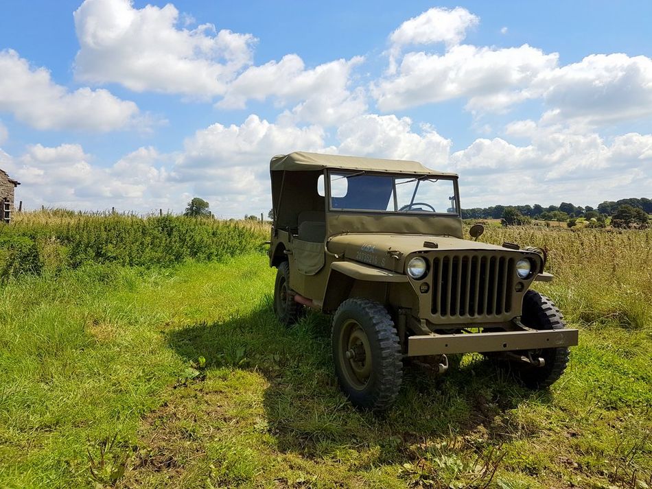

Had some fun today driving the jeep around the countryside, found a quarry and a friendly owner and went for a bit of 4WD action, lovely working the jeep a bit!

Re: 45 GPW268333
Hey Matt
Looking good mate. Interesting to see you've not mounted a spare wheel or gas can
regards Nick
regards Nick
