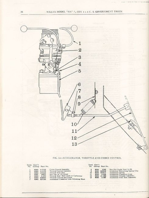

Image Image
Notice the ribs on the top of the carburetor air horn? There are no changes to the carburetor in TM-10-1102 Change No. 1 dated June 25, 1941 or in TM-10-1102 Change No. 2 dated December 1, 1941. The Denver jury finds this factory evidence persuasive that the Carter 450S carburetor used on the MA jeep came from the factory ribbed for pleasure.

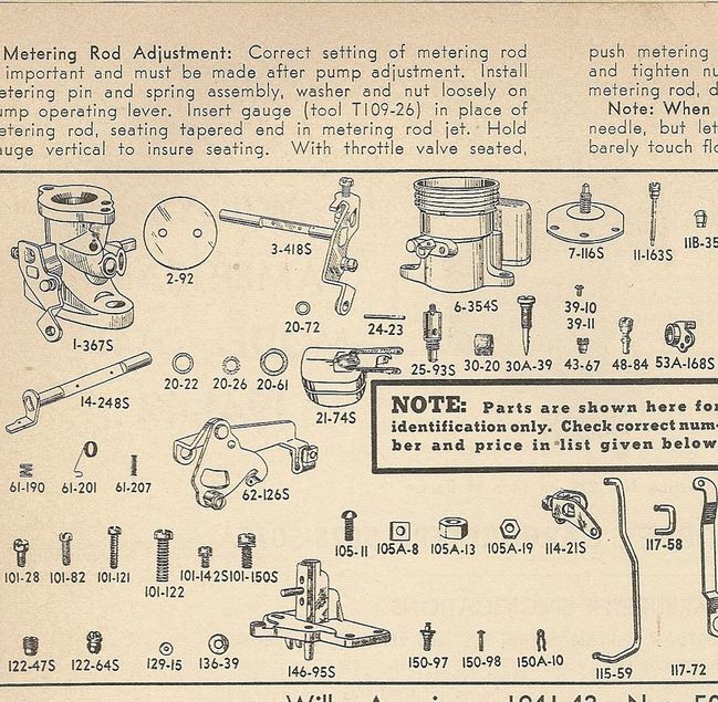

May I propose a new theory. I believe there is evidence that the 450S smooth air horn was the EARLY design from 1939, NOT the late design, and the smooth design was superseded and changed to the ribbed design in 1940.
Below are the spec sheets for both the 450S and 507S carbs.
450S sheet released 1939 (reprinted 1946)
smooth air horn 6-315S was superseded by the ribbed air horn 6-354S
Drawing showing the smooth air horn was not updated to show the ribbed air horn.
507S sheet released 1940 (reprinted 1942)
Drawing shows ribbed air horn.
Based on the Carter spec sheets, the ribbed air horn released in 1940 superseded the old smooth air horn from 1939. Therefore, I believe both the 1941 Americar and the MA had ribbed air horns.
If a 450S is found with a smooth air horn, I believe it was from the original 1939-1940 production.
This would explain why the MA manuals show the carb drawing with a smooth air horn. The drawing was probably from 1939 and never updated.
George
Carter 450S parts 1939-01 text.JPG (248.64 KiB) Viewed 479 times
Carter 507S 1940-01 text.JPG (198 KiB) Viewed 479 times
Willys MA carb manuals.jpg (146.12 KiB) Viewed 479 times

Thank you so much for answering and illustrating the second half of Chuck's question by showing that the smooth top air horn on the early 450S carburetor had a different and lower Carter part number -- 6-315S -- than the later ribbed top air horn -- 6-354S -- used on the MA version of the 450S carburetor. Your nice 1940's dated Carter spec sheets establish, without a doubt, that the smooth top air horn was the early one and the higher numbered ribbed air horn used on the MA version of the 450S was the later one. This proves that the progressive's collective approach is occasionally the best approach: "It takes a motor pool to identify a carburetor." :wink: Thank you for your excellent post with its clarifying illustrations. I believe it is now established beyond argument that the ribbed top air horn on Dave's 450S carburetor is the correct air horn for a 450S carburetor installed on a MA jeep.
