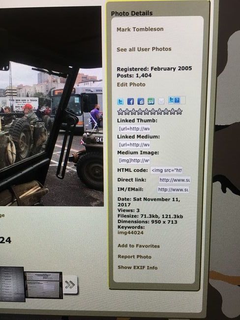

Here is a little photo help, Farrell.
When you pull the photo up in "my photos", click on the Edit Photo... just below your post count.
This will bring up the following page:
You can then rotate or flip your thumbnail which does the same for the larger versions.
Let me know if this works for you as both the above photos had to be rotated 90 degrees clockwise.

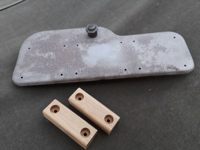

Post by Farrell Fox » Tue Apr 17, 2018 7:30 pm
Some more radio Jeep parts acquisitions to report. An original glove box door in excellent shape, and some repro hood blocks supplied by Ron. I plan to get some data plates from Robert once he's making plates again.
