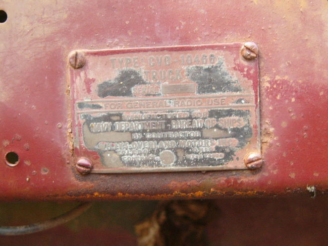

I'm afraid I need to make sure we are using the same terminology here.
Here is what Farrell has on the serial number page:
Navy Basic/MZ-3 CVD 10182-C
Frame: MB 454818........Body: 258604...........DoD: N/A.....................S.N.: N/A...........................Tag No. N/A - A. Smith Added 2-12-16
Frame: N/A................Body: 258700...........DoD: N/A.....................S.N.: U.S.M.C. 120241..................Tag No. N/A - R. Pearson Added 2-12-16
Frame: N/A................Body: 258709...........DoD: N/A.....................S.N.: N/A...........................Tag No. N/A - G. Bull Added 2-12-16
This is the data plate on G Bull's body 258709.
Here is the thread on that jeep... CVD-10466. It appears to be made of Texolite. I have another photo of the same CVD-10466 data plate in brass.
https://g503.com/forums/viewtopic.php?f=84&t=227839
Both jeeps have very close engine numbers 629841 and 630013.
They both appear to be 24v secondary system, MB-NAVY-24 and not the CVD-10182-C (12v) although both are under contract NXsr-79925. This cannot be proven without a data plate.
