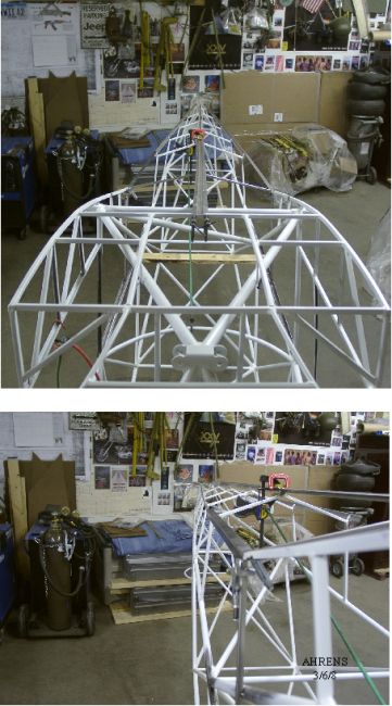

we have the greenhouse about done.
an lining up the stringers to the side angle piece now.
does anyone know if a slight 'bow' is okay
or was the angle piece and stringer in a perfect straight line?
dave
dave
