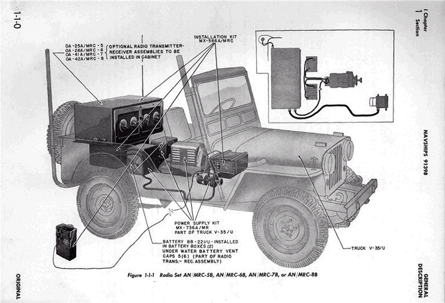

If you have NAVSHIPS 91398, what is the radio set supplied with OA-42A/MRC-8?

Post by Gunner » Thu Sep 06, 2007 5:04 pm
Sorry, I dont have navships.
I found the pic on the web.

Post by Mark Tombleson » Fri Sep 07, 2007 1:36 am
That is a CJ-V35/U.
I would like a copy of that manual also... so, where did you find it so we may track down the owner of the photo?

Post by wa5cab » Fri Sep 07, 2007 11:44 am
The photos belong to eBay user ID 39redfern. If he/she is actually in NY and didn't photograph the three pages and then sell the NAVSHIPS, we now know that there are two in existance.

Post by h8pvmnt » Fri Apr 06, 2018 2:36 pm
Sorry to resurrect this old thread, but the original poster wanted to know what the radio set was for OA-42A/MRC-8B, i have a copy of the Navships 91398 and the correct radio would be the SCR-528 for the AN/MRC-8B(OA-42A). AN/MRC6B would be a TCS radio set. TCS-13 most likely but could have been any TCS SET. I am using the AN/MRC-6B in my current V-35 restoration. The AN/MRC-8B would be very cool as well. The real issue for me is finding the waterproof radio box.
