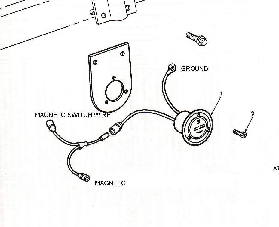

I bought a "new" Mule, rope start, and it has an hour meter on the back. With no electric system what runs it? Wires are cut off, data plate is missing from the Mule so I don't know what model it is. Has Bubba been working on this machine?

I think the magneto runs it

Must be a 4 VDC meter to work. "-" wire is ground, "+" wire is Y'ed into the magneto switch wire. Bear in mind, if the hour meter is shorted internally, it will also ground the magneto and prevent the engine from running.

One of my customers while testing an hour meter noticed it not clocking time with the engine running at idle. The voltage from the magneto was less than 4 volts. Voltage at 2000 rpms was above 4 volts and the hour meter started to run.

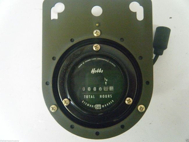

There was a certain parts vendor who was selling 12 VDC Hobbs meters for use in this application and when the meter would not work, he told the customer that they must have damaged the meter during installation and would not refund their money! Vendor is no longer in business!

The regular Mule Hobbs Hour Meter operates on 4 + volts and is wired into the magneto. The voltage from the magneto energizes the hour meter using a pulse of the primary output voltage at the condenser. If your Quartz Hour meter requires a constant voltage then it will short the magneto so it will not run the engine. If it must be connected to a constant supply of voltage the Alternator is a great source.
