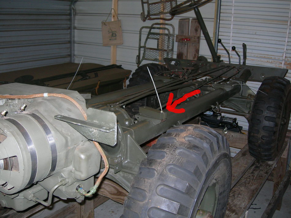

I appreciate the help. I will try post some pictures but I usually have trouble reducing the size. What parts are important to take pictures of to identify the model? It is 2 cyl, mag deck, 4 wheel steer.

The brake drum, the rear deck supports between the frame tubes, and the rear of the deck.
If it is a 2-cylinder and 4-wheel steer, it's one of three models: M274A2, or a converted 4-cylinder model, i.e., M274A3 or M274A4. If it has the small brake drum, it's an M274A3 (converted M274) If it has the large brake drum, look for the 4 holes in the RR of the deck where the right muffler was mounted. If you find the holes, it's an M274A4 (converted M274A1),It will also have 2" spacer blocks on the rear deck cross support. If no holes or spacer blocks, it's an M274A2.

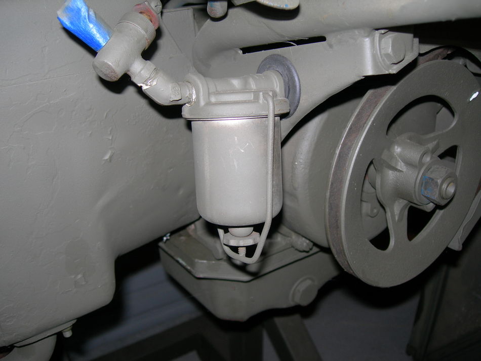

Bubba has worked on the fuel system. Do all mules have the hand primer or just cold weather ones? How about the Gascolator? Mine has neither, but it also had a HUGE hose from the carb T to the gas tank instead of the microscopic steel line. Thanks for the help. Al Hansel

Series 1 4-cylinders all had a cold weather priming pump, but it was an attachment for the 2-cylinders, and is rarely seen. Check this thread:
viewtopic.php?f=79&t=275489&p=1606388&h ... g#p1606388
All the 2-cylinder engines use the fuel sediment bowl (Gascolator). There is also a fuel filter on the pickup tube inside the fuel tank.
viewtopic.php?f=148&t=205307
Return line from the carb "T" to the fuel tank should be 1/8"
