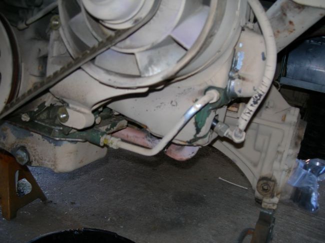

One thing that has to change is the oil drain line on the right rocker box:
Here you can see the alternator mounting bracket and the new oil drain line. Couple of things to keep in mind, you may have to do a little "sheet metal work" on the shroud in order to screw the elbow into the rocker box, and BE CAREFUL, don't over tighten the elbow into the rocker box, it is very easy to crack the housing and cause an oil leak. This is just a drain line, there is no pressure, so snug is fine.

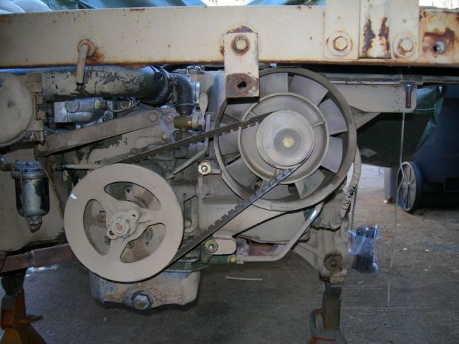

Once the alternator is mounted and the belt installed, you'll see that the lip on the blower will need to be modified.
I used a cut-off disk in my 4 1/2" grinder to cut the lip back.
Here you can see the complete installation, I like the way the alternator tucks in under the blower and uses the same drive belt, no need for the double crank pully. Some people mount the adjusting bracket to the engine guard, but I make a bracket that ties back to the bottom of the bed.

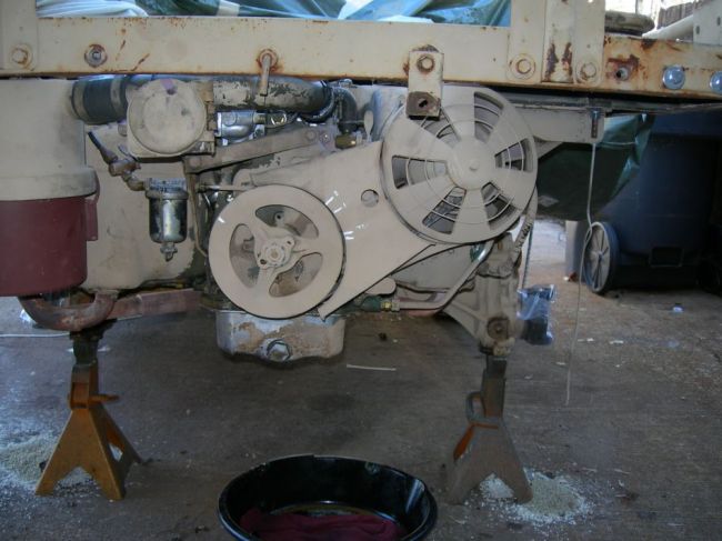

The belt and blower guards complete the installation. I cut just a little off the bottom corner of the belt guard to clear the belt. You want to keep the belt guard because it has the timing marks.
Here's what makes this so nice, it's a true "one-wire" installation, this single wire ties into the electrical system, either at the positive battery terminal at the starter, or to the positive terminal at the battery. Wherever you tie it in, be sure to install a 30 amp in-line fuse.
Here's the complete installation. Very clean and works great.
