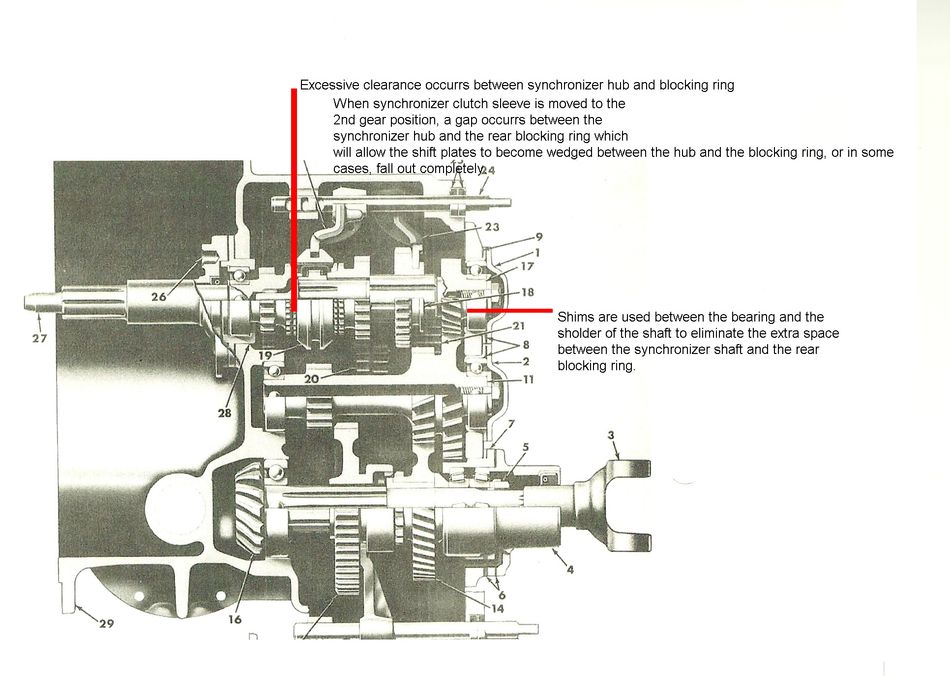

- G-Lieutenant General
- Posts: 5073
- Joined: Wed Dec 18, 2002 1:00 pm
Re: Problems with new to me Mule
Keep in mind that you cannot "speed-shift" a mule between 1st and 2nd....take it slow and easy. If you try to jam it into 2nd, you can force the clearance in the synchronizer to open up which could allow the the shift plates to jam in the gap.
