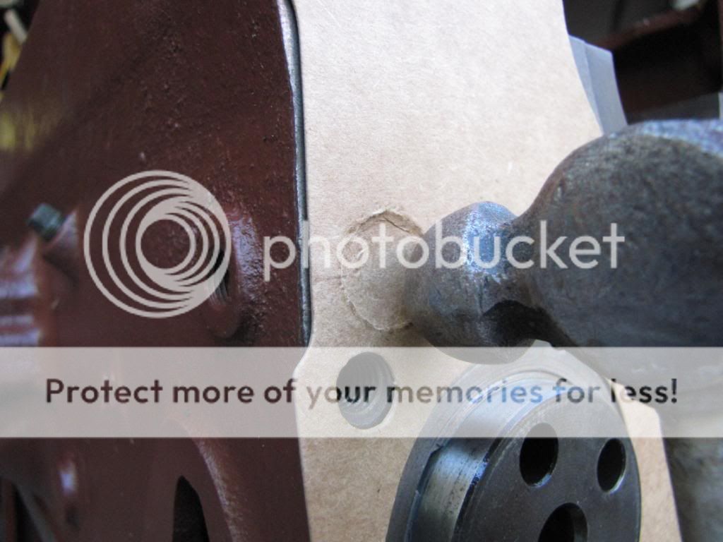

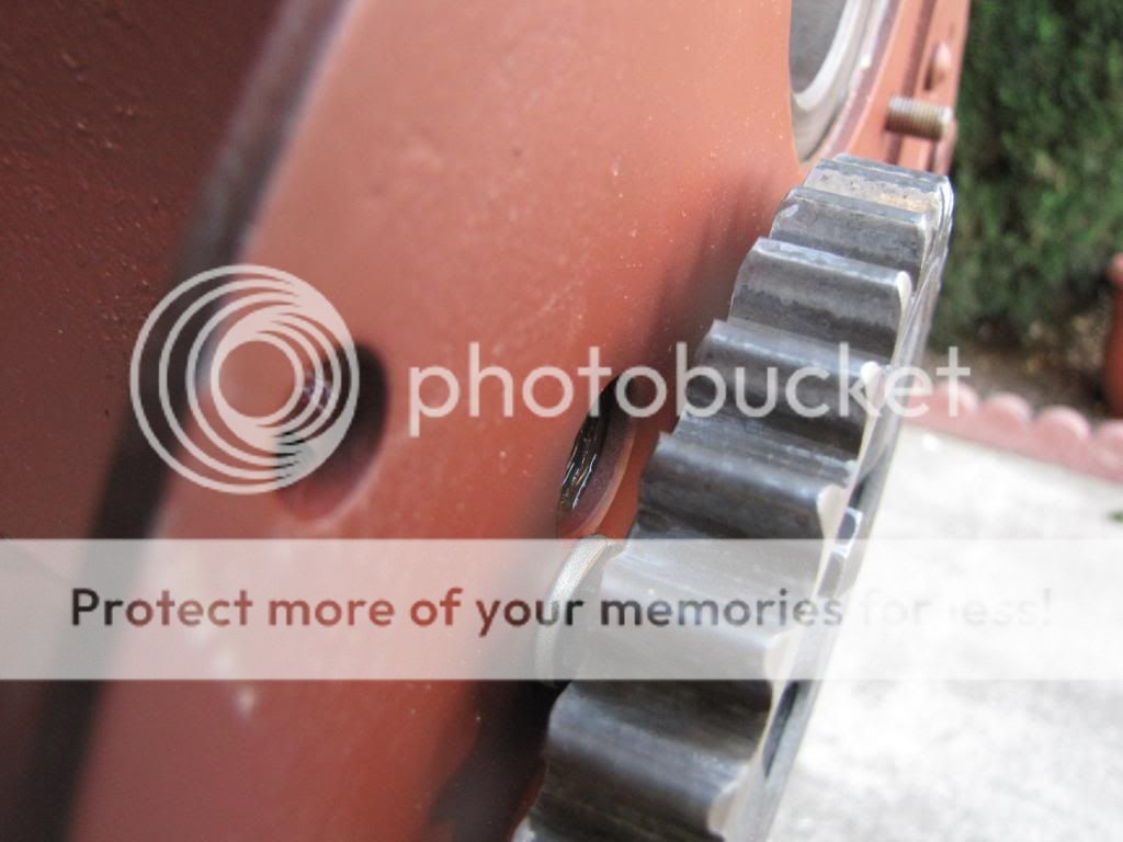

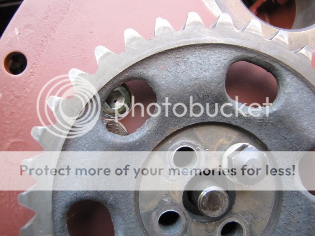

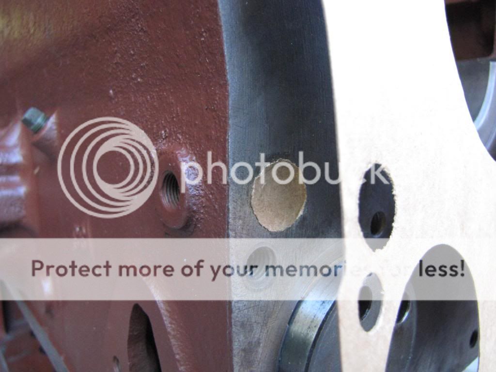

For a little extra chain oiling, I drilled a small oiling hole in the front block pipe plug, and a corresponding hole in the front plate on my friend's chain drive MB block with a gear drive crank. Here's how I did it.

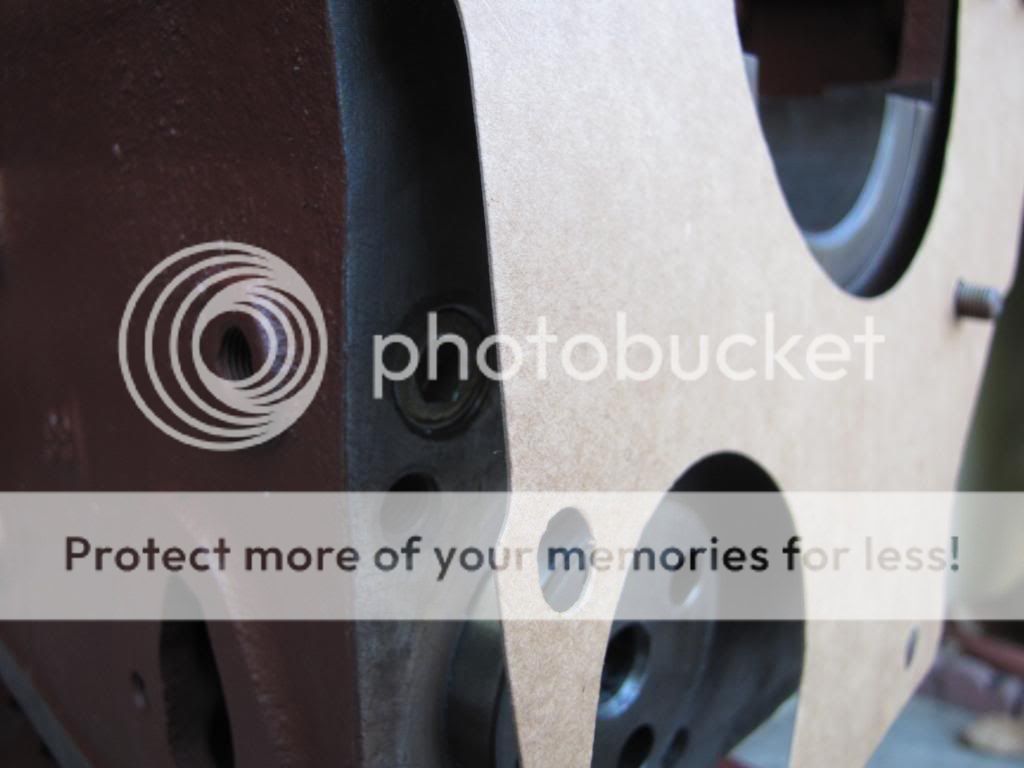

While the engine is apart, take a timing plate gasket and use it to get the location for the hole in the front plate:
Then use the gasket to mark the location on the plate to drill it for the squirter.

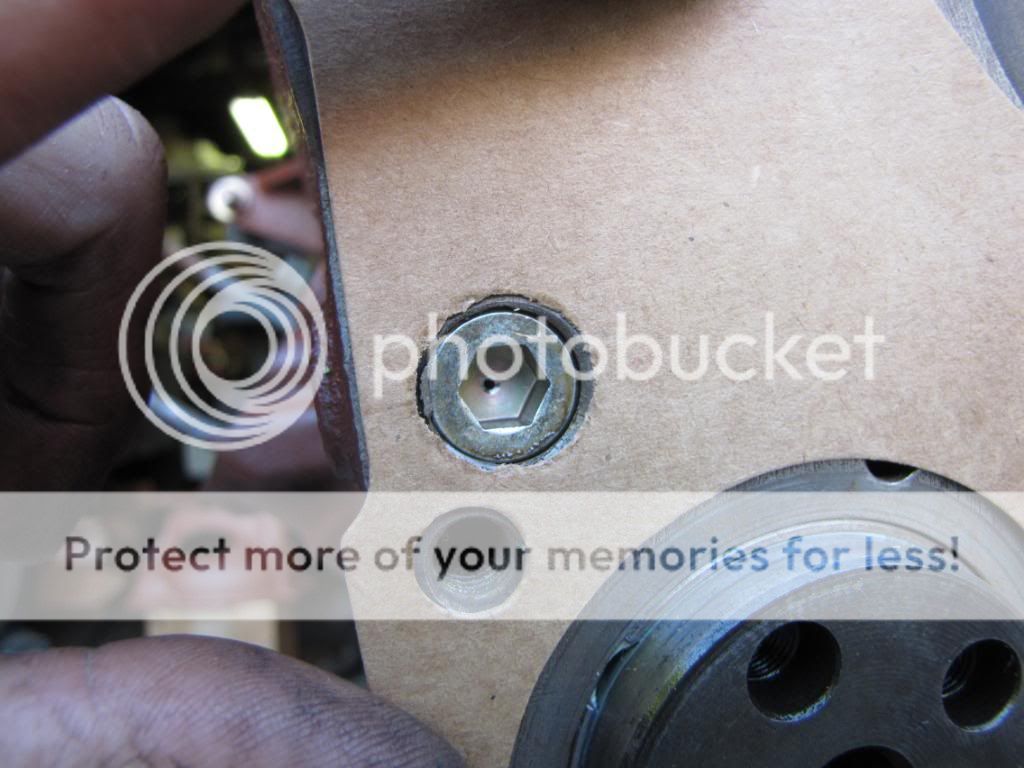

I used a new pipe plug and drilled a .040" hole in the center of it to act as a squirter. The hole is the same size as the jet on a gear drive engine.
Here's the oil hole that needs to be drilled to match a chain drive crank:

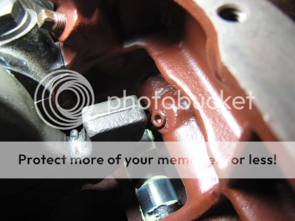

Here is the pipe plug inside the block that will get hit by the counterweighted crank, you must fit a flush plug here. The person who assembled the engine previously to me left the stock plug in and it was hitting!
This shows the counterweight easily clears the pipe plug now. No other mods were needed inside the block
Hope this helps!
