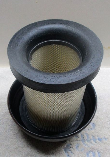

UPDATE: February 25, 2017.
Here are the available materials I used in February, 2017 to modify my Oakes No. 613300 oil bath air cleaner into a paper filter element air cleaner:
1. One (1) NAPA GOLD air filter #2036 @ $8.49 (or equivalent -- see earlier posts for their part numbers).
2. Two (2) sponge gaskets for wall hung toilet 5-3/8" OD x 3-1/2" ID x 3/4" thick @ $5.27 + shipping from http://www.plumbingsupply.com.
as seen here:
Here they are assembled right side up:
After the internal oil bath filter screen is removed and the air cleaner and bottom cup are cleaned and dried, turn the air cleaner upside down for assembly and place one ring in the top of the air cleaner. Insert the air filter and center it on that ring. Place the other ring in the bottom of the bottom cup and center the bottom cup on the upside down air filter. There is about 1/2 inch of available compression before the two clamps are positioned to hold the bottom cup in place, as seen here:
Shaking the air cleaner after the clamps have been tightened suggests there is enough clamping force to prevent the air filter from moving. But if you want a bit more clamping force, cut a disc of suitable material having a suitable thickness with an Outside Diameter (OD) of 5-3/8" and place it in the bottom of the bottom cup before inserting the foam gasket in that cup.
After the air filter is installed in your jeep, you should be able to change the paper air filter element by simply unclamping to bottom cup, removing the old element and installing a new paper element in its place. Happy jeeping on . . .

- G-Lieutenant General
- Posts: 5842
- Joined: Thu Mar 09, 2006 12:34 pm
Re: MB GPW Dry Air Filter Conversion Done
Good job tracking all that down!
I would suggest painting the inside of the oil cup, since any water that may get into the air cleaner may cause rusting.

- Fred Coldwell
- G-Brigadier General
- Posts: 2121
- Joined: Sat Dec 14, 2002 7:12 am
- Location: Denver, Colorado, USA
Hi Marty:Marty, SoCal wrote:Good job tracking all that down! I would suggest painting the inside of the oil cup, since any water that may get into the air cleaner may cause rusting.
I thoroughly scrubbed, cleaned, dried, primed and painted both the inside and outside of the Oakes No. 613300 air cleaner and its bottom cup before assembly, but forgot to mention that step in the summary. The 1/2 inch of available compression shown in the upside-down photo nicely matches the operating range of the two clamps, so when the clamps are closed everything is nice and tight. Thanks too, Alan. Let Freedom ring anew!
